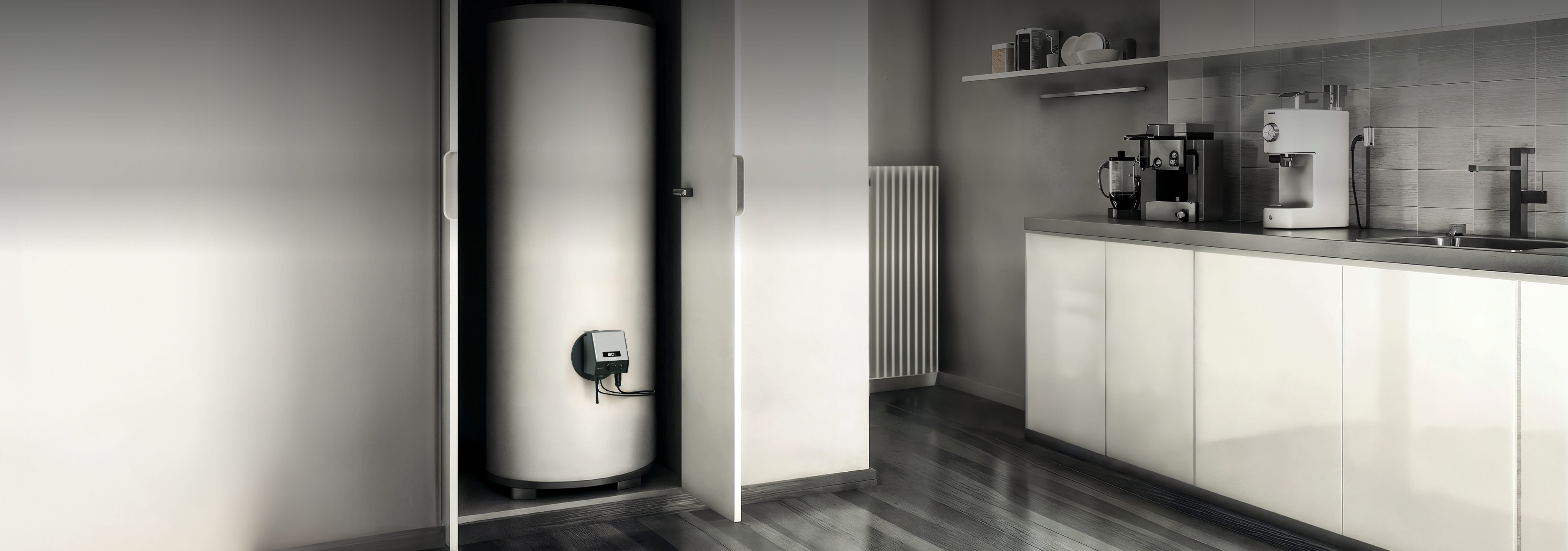

Immersion heater thermostat installed in modern home utility area
